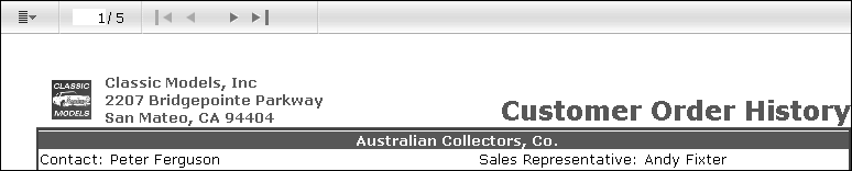

The Standard Viewer displays the report with toolbar options to save, print, show the TOC, and launch interactive mode, as shown in Figure 7-1.

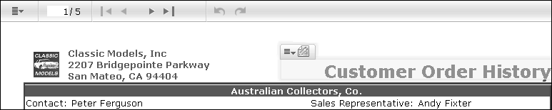

Figure 7-1 Standard ViewerThe Interactive Viewer displays the report with toolbar options to navigate the report and provides context menus to edit and format report elements, as shown in Figure 7-2.
Figure 7-2 Interactive ViewerThe viewer supports rptdocument file formats.
