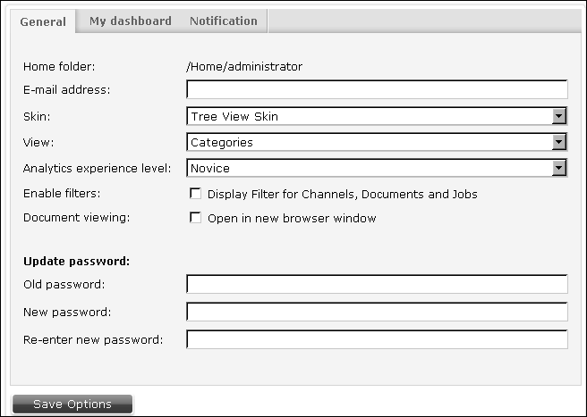

Updates the user options and settings on the server.
An Options page looks like Figure 5-11.
Figure 5-11  Options page

Table 5-27 lists and describes the parameters for the options page. The options page also uses the common URI parameters.
Table 5-27  Parameters for options URI
Indicates whether to generate completed request notifications for failed jobs. Enable to generate notifications for failed requests, Disable otherwise.
Indicates whether to generate e-mail for failed requests. Set the value to "on" to enable or "off" to disable.
Indicates whether to use filters for the Request page. Enable to use filters, Disable otherwise.
Indicates whether to generate completed request notifications for successful requests. Enable to generate notifications for failed requests, Disable otherwise.
Indicates whether to generate e-mail for successful requests. Set the value to "on" to enable or "off" to disable.
Indicates whether to view documents in the current browser window or in a new browser window. Set the value to "on" to view documents in a new browser window or "off" to disable.
