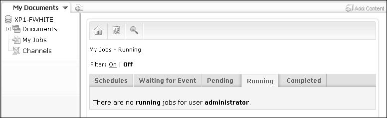

Lists all jobs that were executing when the running page was last refreshed. The list is not live. To view the current list, the user must refresh the browser. Users access the running jobs list by choosing Running.
The Running page looks like Figure 5-14.
Figure 5-14  Running page
