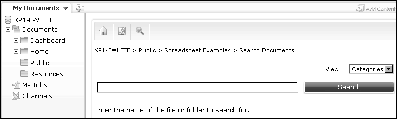

A search results page looks like Figure 5-17.
Figure 5-17  Search results
