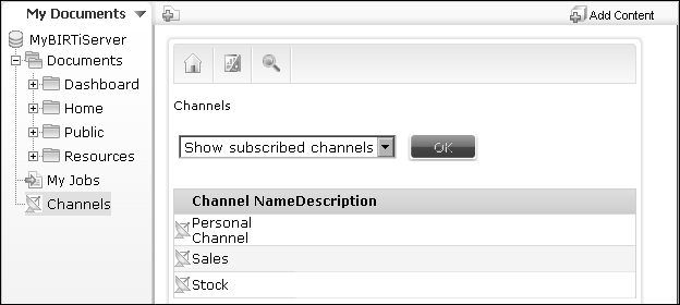

Figure 2-43  Showing subscribed channels

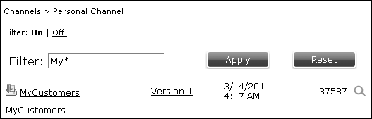

Figure 2-44 shows a channel notification as a summary of the file job.
Figure 2-44  Viewing personal channel notifications with a filter

Information Console provides every user with a Personal Channel. This channel lists the user’s most recently completed document file jobs. Choose Channels to view the currently subscribed channels or to subscribe to a new channel, as shown in Figure 2-45.
Figure 2-45  Viewing available channels

Filtering channel notifications limits the notifications shown to a user. Use the same process as filtering files and folders to find a report within a channel. Choose Filter On and type the search string. Use the asterisk (*) special character to search for unknown characters.
