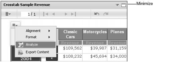

Maximize a cross-tab gadget or a report gadget that contains a cross tab by selecting Maximize. Optionally, double-click the cross-tab gadget title to maximize the gadget. If the maximized gadget is a report or reportlet gadget, right-click the cross tab and choose Analyze, as shown in Figure 3-48.
Figure 3-48  Launching BIRT Data Analyzer from a maximized report gadget

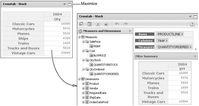

If the maximized gadget is a cross-tab gadget, BIRT Data Analyzer opens as shown in Figure 3-49.
Figure 3-49  Launching BIRT Data Analyzer from a cross-tab gadget
