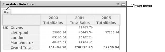

1
Figure 3-54  Opening a cross-tab gadget’s viewer menu

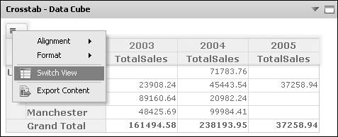

2
Figure 3-55  Opening a gadget’s viewer menu

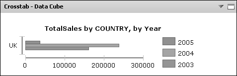

The chart view appears, as shown in Figure 3-56.
Figure 3-56  Opening a gadget’s viewer menu
