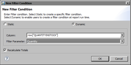

1 Select the element to which to apply a dynamic filter condition. For example, select a data set, a table, or a chart whose data you want to filter.
3 In Filter Parameter, select the dynamic filter parameter to update this filter with user-specified values at run time.Figure 20-3 shows an example in which a QUANTITYINSTOCK field is bound to a dynamic filter parameter named Quantity.

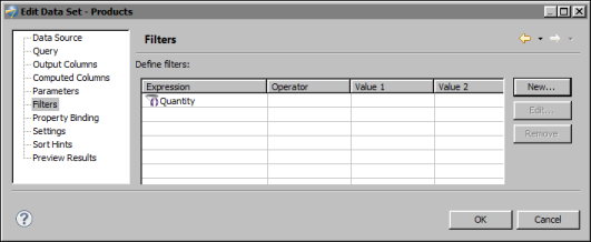

Figure 20-3 The filter appears on the Filters page. Figure 20-4 shows the Quantity dynamic filter on the Filter page of the data set editor. Unlike a static filter, no values appear under Operator, Value 1, or Value 2, indicating that these values are specified at run time.
